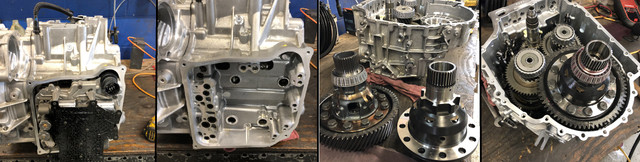

I installed a wavetrac front LSD in my TTRS DSG. About 500 miles after install I received the P176B error. I disassembled the mech and inspected oil tube rubber seals and solenoid screens. Nothing was damaged. I then inspected and changed both the filter and fluid just to be safe. The code remained but after clearing a couple times it went away for about 500 miles. Is there any way to identify if this is a mech issue or a physical transmission issue? The car has less than 12,000 miles so it's unlikely the clutch.
If anyone has seen this problem before I would appreciate any help you can provide. I don't want to buy a new mech only to find out that there is a problem inside the box.

When the code is not present the car drives beautifully.
When the code is present I don't have any even gears or reverse.
I did start a ROSS-TECH post but so far there has been very little feedback.
From all of my search I believe this is a mech unit issue but I don't know what component has the issue.
It could the any of the blue solenoids, the screens behind them, it could be foreign object obstruction in the valve body, it could be improper seal for the oil stand pipes .......
I would like to load up VCDS and look at all the pressures in the unit but I don't know what they are supposed to be even when I look at them. Very frustrating to simply have a $ 1500 black box filled with $ 50 components that you can't troubleshoot due to lack of informaiton.
